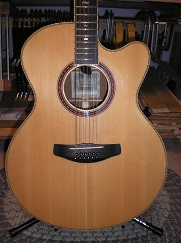

Andy, Here's a Yamaha 12string SJ shape of mine.I like the tone it has,not too boomy.It also sounds very good plugged in.Not bad at all for an import!
